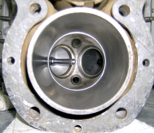

1. I took a standard valve seat grinding pilot and shortened it enough so that I could fit it through the cylinder liner and into a valve guide.

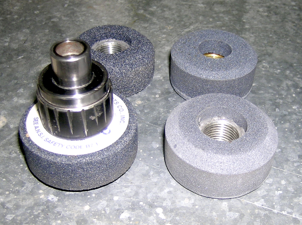

2. I shortened a standard valve seat grinding stone holder so that it would fit through the cylinder liner and onto the pilot.
3. After fitting the coarse stone to the holder I (and my son and friends) would reach down the cylinder liner and pushing the holder and grinding stone against the valve seat and turn it perhaps 1/8th of a turn, and repeat and repeat...
4. After getting a good even surface on the valve seat, I would repeat this process with a fine grit stone.

Shortened pilot in place
Shortened holder and stones - note that with two different valve sizes I needed four stones. I also scored the sides of the holder to give our fingers better grip
Motor 7.jpg (277.5 KiB) Visto 6102 veces
Motor 8.jpg (298.77 KiB) Visto 6102 veces
